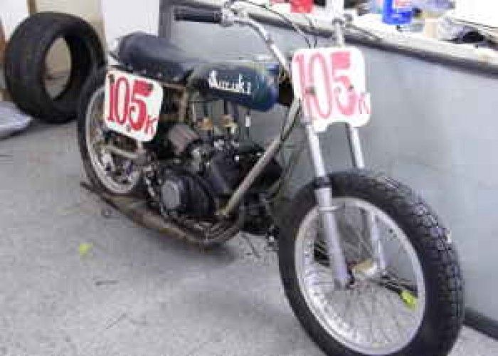

This is along the lines of my T20 Suzuki weapon that Pete was keen to help me with, injury and financial's put a stop to that
Hey Steve, do you still have the Suzuki Hustler? I reckon once you make a start start on it, the motivation to finish it will come back. Finishing the little 360 tracker that had sat gathering dust for two years has pumped a lot of my previously missing mojo back into my system to the point that I'm jumped straight into the next job....finally finishing the Hindall motocrosser which has had four or five false starts over four years. Finishing a race project is the best cure to all sorts of ailments, I'd almost forgotten why I started doing this in the first place but it's all clear now. ;) Give it a shot Steve, you know you want to blow Jimmy and his new/old Trumpy off ;D
stick the 315 barrels and carbs onit  ;) still comeing to grips what the zook was mauling out there in the real world, no wonder they called them the Norton slayers

The T20 is for sale if anyone is interested?
It's still an original, 99% complete road bike but has been completely stripped down.
