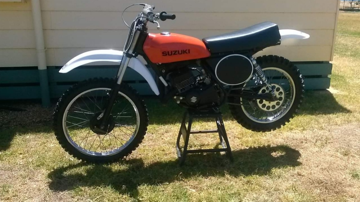

Just finished building it, made me feel 14 again :-)

I can see it now. Looks very nice. Bikes from that era have so much more character than the moderns. If you painted all the modern stuff the same colour you wouldn't be able to tell them apart on the track.
What year period is it meant to be in? Did you find anymore top end?

Yeh I guess we all prefer the older stuff, I feel the same about cars. Yep found the top-end, turned-out that I'd fitted a piston with only 2mm off the skirt, swapped it for an RM125S piston (and rings) with 6mm off the skirt :-)

Nice job. Any chance you can get a better/more lit photo that shows what the side covers are? its very dark so i cant really seen any detail of those. Thanks
