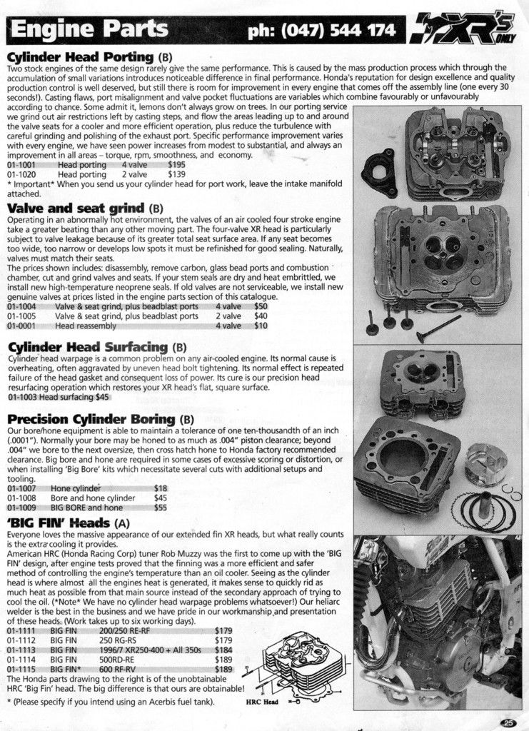

Leith also sent me this sheet in addition to the one he posted.
You will read where they offer a service for the repair of cracked heads, but they make mention of this fault being on the 250 hondas and TTs not the open class XR.
None of my open class heads are cracked, although some have inferred that they do. So I chose not to believe it unless they vouch of a first hand experience. Maybe just one of rarity or a myth grown on "if the two fiddys do? they all must" ::) ::) ::) ::) ::)
So at this stage I am no longer sure about the trouble and weight addition of a the big fin head. Maybe just cooling the oil would be a more logical path.
I have a few ideas about along that line to pursue first.

Although, you got to admit that those big fin HRC heads look pretty funky  8)
Ironic when it comes to cool, they look a hell of a lot cooler than a chrissy tree full of oil coolers.

i went to classic dirt at lithgow and was looking at a bloke from victoria's C&J replicas.They had XR500 engines with every 2nd fin on the head and barrell milled off. He claimed that they ran cooler than a standard XR. I mentioned about the big fin heads of the 80s. He claimed it was a sales gimmick and did the opposite to their claim, The example he gave me was, the 60s and 70s huskys and ktms had HUGE barrell and head fins , to keep the heat in.
Re: Open Class XR race development and advise
« Reply #71 on: July 14, 2016, 08:02:50 pm »
I don't think hrc would go to all the drama of welding big fins on for a gimmick...would they...?
Yeah, but the big fins still look pretty funky ;D
Is it the CCM's that they trim as well?
I think maybe a 500tt that Ola Martin has as well?
Yeap, I think I might save Pete the trouble and go for light weight oil cooler approach first :)
