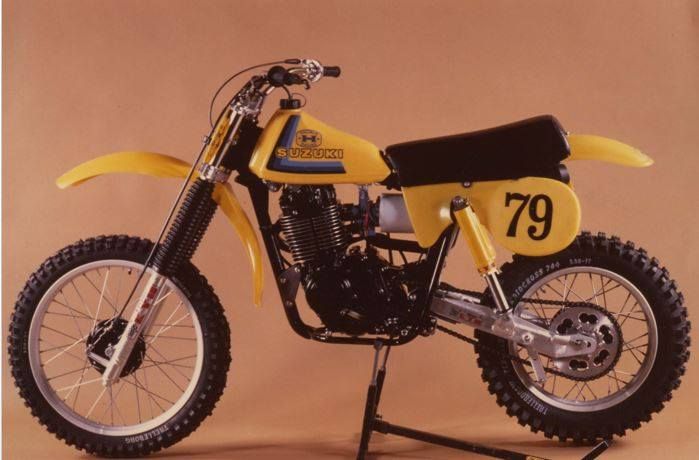

That's a good point. I want to see someone buy one of GMC's frames and build one like the above photo.

The back of that bike looks wierd, plus the air filter looks like an after thought .....
Re: Four stroke options
« Reply #58 on: June 08, 2016, 09:10:48 pm »
I agree with the filter, needs an air box. Rear fender looks a bit short.

My thoughts are the same as yours ...
Read article  ....last paragraph  sums it up well
