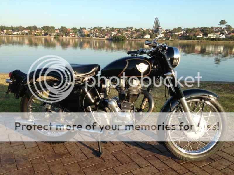

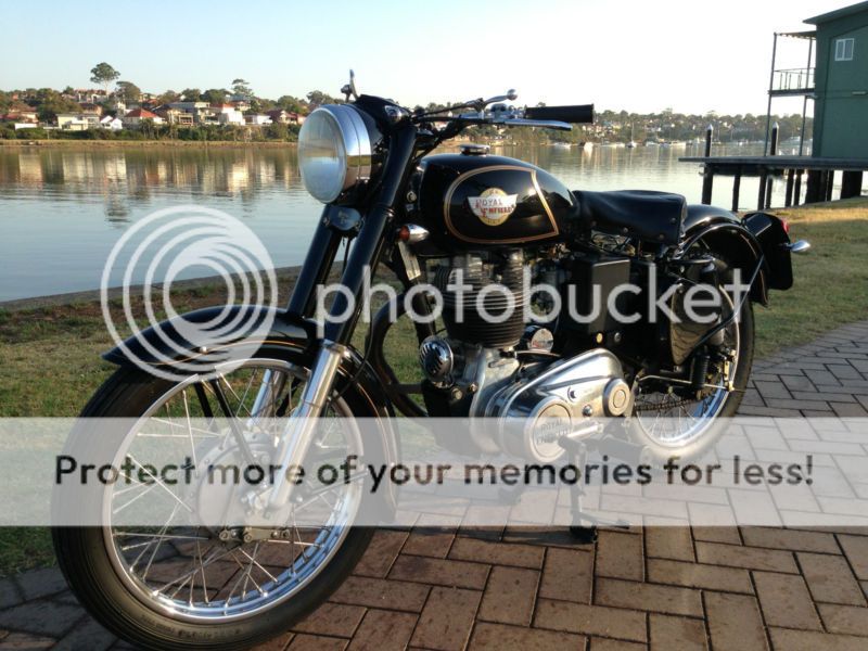

This one is currently on ebay in Sydney.
http://www.ebay.com.au/itm/231035214309?ssPageName=STRK:MEWAX:IT&_trksid=p3984.m1438.l2648
So question please
Is this one pre-60 legal
thx in advance.
Montynut
Re: Indian Enfield's
« Reply #13 on: August 28, 2013, 12:04:57 pm »
My research says NO because while it is still an iron barrell it has the electric start and also the 5 speed gearbox. The 5 spd G/B casing is a lot different to the '59 based 4 spd. Other than those two things it would be legal although I am sure there are others much better placed to comment.
« Last Edit: August 28, 2013, 12:07:53 pm by Montynut »
« Reply #14 on: August 28, 2013, 12:06:33 pm »
Thank You.
