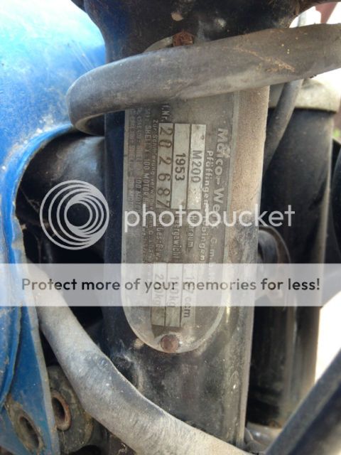

Does it have anything on the ID plate?
In typical Maico fashion the plate has 247cc and no date whatsoever.
Actually Mark, that is not the case in the MotherLand. In fact ALL of the Maico bikes and frames that I have seen on German Ebay for the last six years do have the date stamped on them. It has been a reasonable classroom(German Ebay).
Who knows why they weren't date stamped when Exported? Could be a multitude of reasons :-\

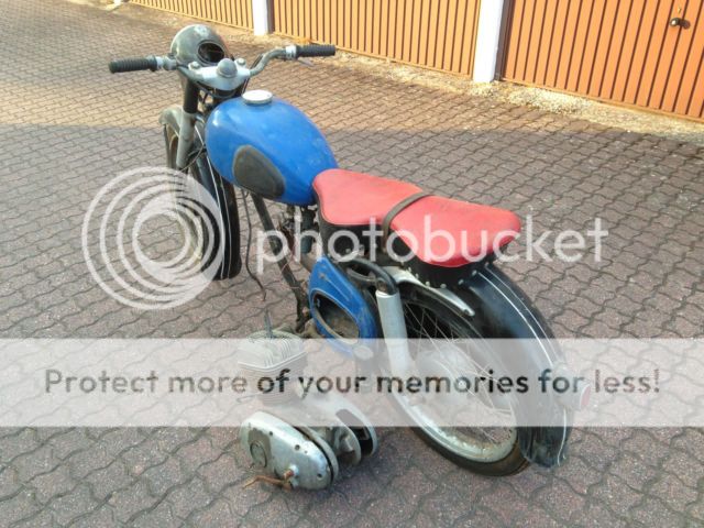

Incidentally, this is another earlier blizzard currently on German ebay at the moment
http://www.ebay.de/itm/MAICO-M200-1953-/121162115560?pt=Motorr%C3%A4der&hash=item1c35d329e8
It too has its ID tag dated
Just like all Maicos sold inside Germany to their Home-Land domestic market up till the first major fracture of the Maisch Brothers reign.

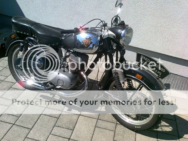

You're an intrepid explorer for the early Maico cause Micky ;D. You and Rodger should be right for pre 60 now, leaving pre 65 ovals to little old me ;D.
Below: AL161's iron barrel oval Maico approaching completion.

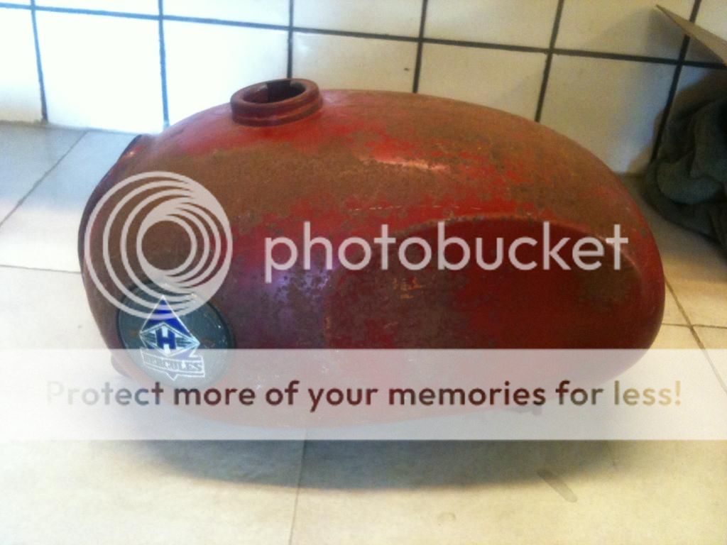

Don't know very much about this, but the ebay tank you linked to looks like the one that was on my GS.
Wich is pretty big.
The one Mick bought from me came of a MC model, and is quite a bit smaller. (wich as you can se is the same as the Hercules)

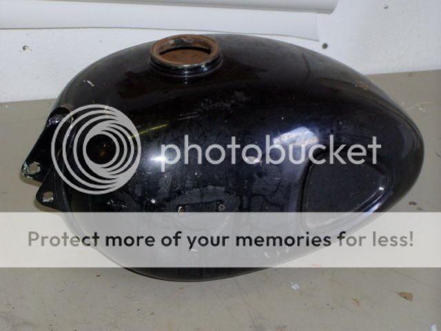

I think there are four different sizes of this shape Maico tank
That particular seller is very decent to deal with Firko and he has two of those same tanks for sale, both black.
He speaks english and his charges are fair with tracking.
The smallest of that shape come on the M175 and M200
The largest from the 400 Taufin twin cylinder roadies and there seams to be two other sises used on the intermediate roadies and GS models. I think the GS 360 models and 350cc twin Taufin use the third largest sise.
I would like to know the fluid capacity of each.
I would be prepared to pay mega bucks for this 277cc Blizzard tank, for my early GS or SS projects.
