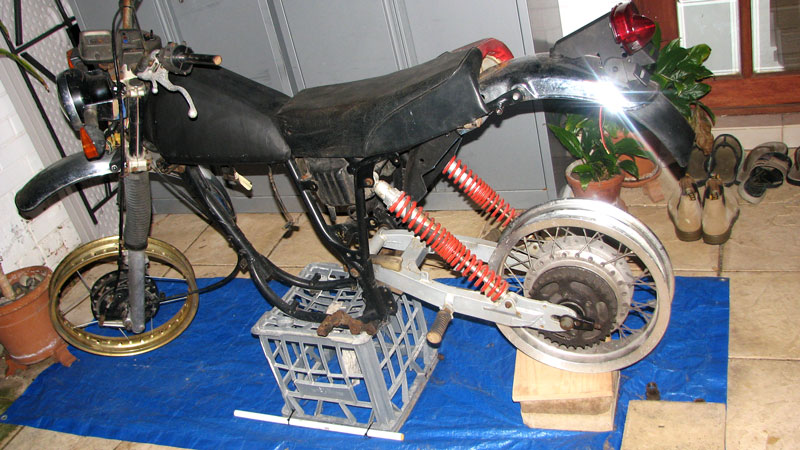

Last night I fitted the 16x3 inch rear wheel and 17x2.15 rim to DR front hub as pictured. The rim needs to move to the left by 10mm to sit in the middle of the swingarm. To achieve this I am going to machine about 10mm off the face of the cush drive and redrill to suit DR sprocket.

Mocked up what is going to be the final front wheel and fitted it to the bike.
