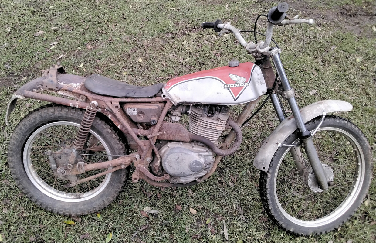

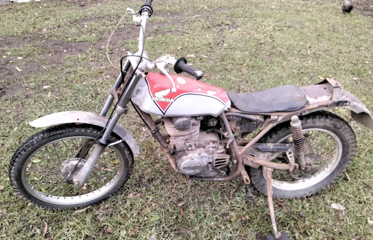

Hi Sleepy,
Is this what your friend desires? As you have probably guessed, the cam has worn into the head and it does not go. Other bad points should be clearly seen in photos.
To end on a high note with some good points, the chrome on the forks only has minor pitting,  the air cleaner and seat base are not rusted out and the brakes work. 8)

That's a real gem!!! I'll send him a link but could be a bit far gone.

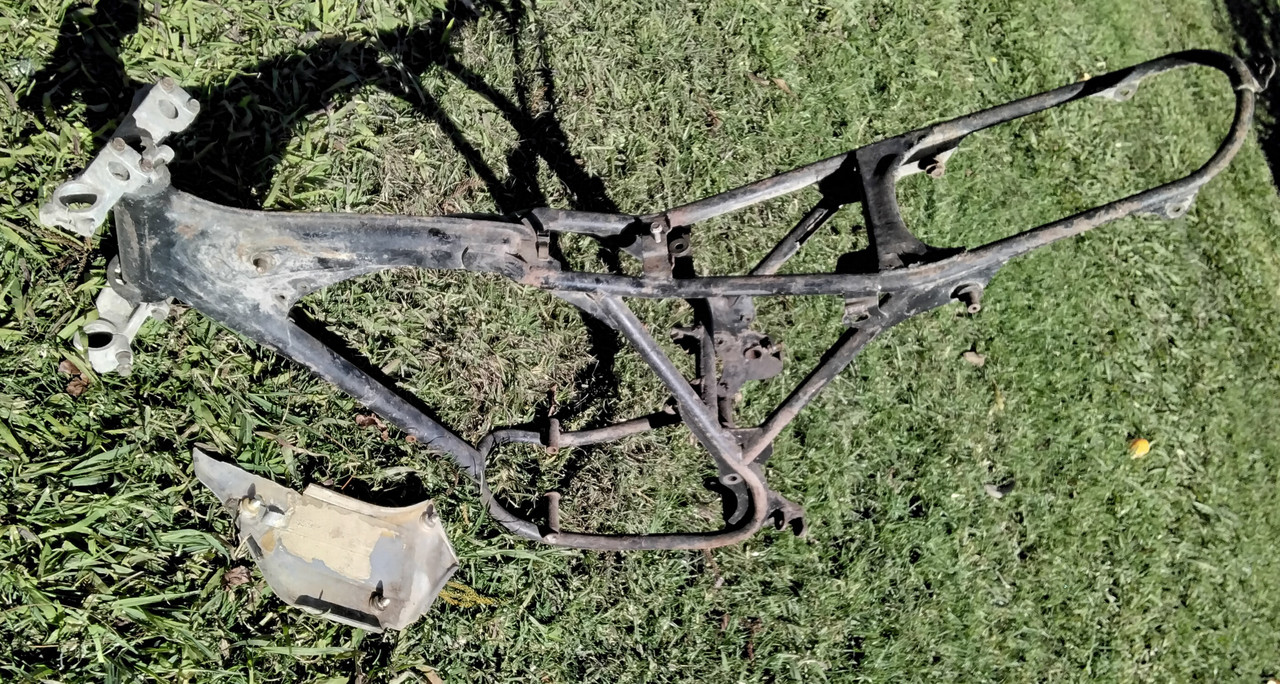

Hi Sleepy,
Yes I agree about the real gem bit! There are other TL 250 parts from other bikes here but not much in the way of cosmetic bits. These bikes did not come with matching engine and frame numbers, Here is the spare frame complete with compliance plate for club rego if he is that way inclined:
