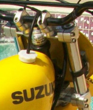

Has anyone got a photo of what the exact triple clamps look like as there are a number of different ones out there. I have seen som with 1 pinch bolt on top clamp and others with 2 pinch bolts but i think 2 pinch bolts (allens) is 1980 Canam?

I have some 38 mm Marzhocchis that I bought off a forum member. They came with some triples that came off I think a 77 KTM. I can send a photo if it will help. Cheers Jerry PS if you need to rebuild forks Flower Pot Ben on here has heaps of spares appropriately priced and a pleasure to deal with.

« Reply #6 on: September 16, 2016, 06:34:22 pm »
Thanks. So these have just 1 10mm? pinch bolt at the top. Probably will be after this type.
Is that big hole in the bottom clamp for a steering lock?
I will probably wait to see if my forks ever arrive anyway. Of course it would be so much easier if i could find some Simons clamps too.
So this type was not around in 77 or earlier?

Not sure about that hole in the lower clamp as the set I have do not have it
