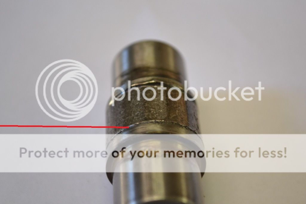

Just thought I'd share the latest bit of butchery I have come across.
Had an RM125B crank turn up for a rebiuld and the first thing that looked funny was the rub marks on the sides. Measuring it I found it to be almost 1mm wider than others I had seen. After it pressed apart I found a stepped pin and a later rod fitted with a larger big end bore. Thats ok but the thrust washers were to big for the recess and that's why it was to wide. The next strange thing was the appearance of the wear on the pin, looked almost like it had milled flats machined into one side which I hadn't seen before. The pin had been properly made by the look of the grinding finish on the un-worn sections but after a quick file test I found it hadn't been hardened.
Makes me groan to see stuff like this and am amazed at how shops could charge for such work.

« Reply #3 on: February 26, 2016, 02:29:34 pm »
Thought I'd upload a photo(if it works) of the pin. Also pretty sure I know who made it or at least who sold and had it fitted, won't post the name publicly.

Re: Crankshaft butchers.
« Reply #6 on: February 26, 2016, 09:57:16 pm »
That can't have been heat treated correctly/if at all  :o The bearing has just been rocking back and forth. Had the big end disintergrated?

« Reply #7 on: February 27, 2016, 12:26:14 am »
The rod and bearing look quite ok. Definetly not heat treated or completly wrong steel used. The quality of finish on the pin is quite good but that didn't help the poor guy that paid good money for a crank build.

« Reply #8 on: February 27, 2016, 11:33:35 am »
Who ever produced this has thought of it only as a crankshaft pin, Instead of a crankshaft pin and Bearing journal
Hardened bearing journals don't disintegrate in the way that this surface has.
Although Bearing Manufacturers use slightly different nominations of high carbon high chrome steels.
52100 bearing steel is a good choice for such one offs.
It will still produce a very good high performance result.
A couple of reasons why:
52100 will machine well in the hands of any competent turner.
No need for induction hardening(as performed by manufactures prior to grinding).
It can simply and safely be case hardened at home.
Then sent to a Cylindrical grinding machine to finish the bearing journal surface.

« Reply #9 on: February 27, 2016, 11:45:10 am »
Steel is no longer malleable after hardening.
These raised up ridges are a characteristic indication of still malleable
