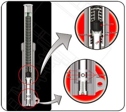

Any suggestions out there on what might be causing this severe fork gouging problem. (TM250L forks)
I had PD valves fitted and after the first race deep gouges started to appear on the stanchions. Got RAD to re-chrome them, same problem. Tried a different set of sliders, re-chromed again-same problem. There was also fair bit of fine alloy particles floating in the oil when i drained them, possibly came from the emulators by the look of the marks on them.
- quality 10-15wt Motorex oil used. 120mm air gap.
- damper rods modified (but shortened  :() to take the emulators.
Suspect the material being stripped off the emulators may be getting lodged between the stanchion and slider which could be causing the deep gauges - but why?
ideas anyone?

Pokey they are assembled in the correct place, inside the fork tubes on top of the damper rod with the spring on top of that with pre-load. the standard variable rate springs with replaced with linear one as part of the conversion job.
There were also no top out springs in there, but i'm not sure if that is standard or not on 74/75 TM250 forks. there was a holed spacer and washer set up located inside the tube at the bottom which could be for a hydraulic top out mechanism instead of a spring - if anyone knows?
