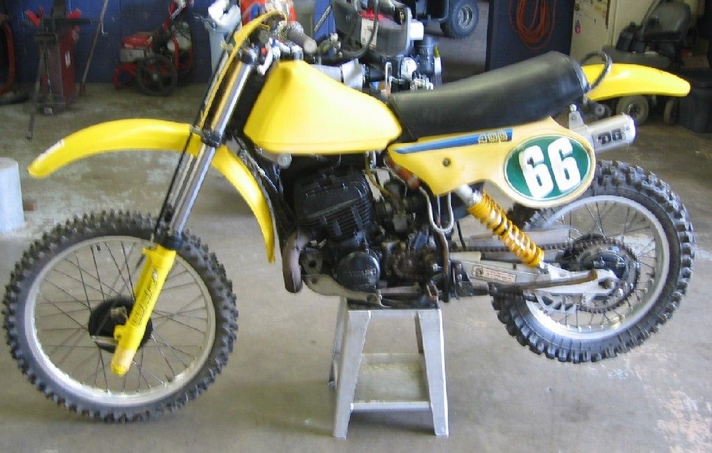

I know a guy in USA who got a Clarke RM250/400 tank 79-80, 8.37 Liter capacity. He has it on his PE400 and it fits well. I will get a photo for you.

Hi ,... Thanks Old Fart, and LWC82PE for all the info, and the photo of the Clarke RM tank. If you can let me know what's entailed in fabricating the front mounting brackets that would be great.

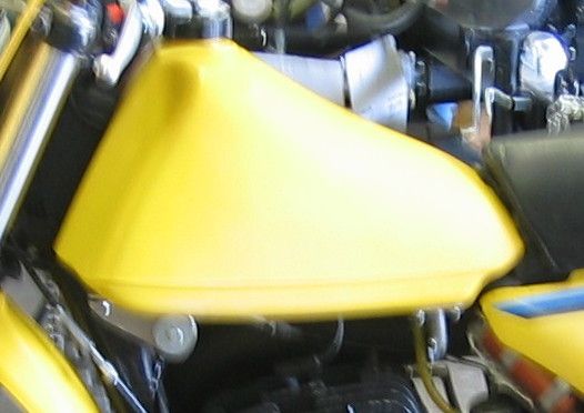

A threaded tube that spans the frame going through the round hole in the head stock reinforcement was used to mount a tank on an RM l bought.

« Reply #5 on: January 07, 2016, 05:15:19 pm »
On the photo i posted you can see he made longer brackets underneath. I can post a zoomed in photo of that area later as i have reduced the total size of that photo already.

« Reply #7 on: January 07, 2016, 06:49:51 pm »
The PE frames are essentially the same as the PE so the tank will fit, its just the RM seats are a different shape/a bit longer at the front and the front mounting point is a bit different on the frame. Plenty of guys have run the 79/80 RM tanks on PE's before. Even ex Suzuki works rider Drew Smith runs this tank and he is also using the DC plastics RM safety seat conversion on his PE250.
