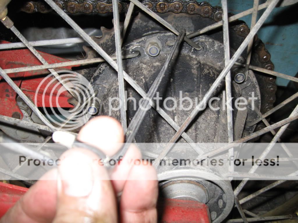

YAMAHA  you know you want one !!!  Viper #50
Re: A handy little tool.
« Reply #8 on: August 06, 2010, 07:39:32 pm »

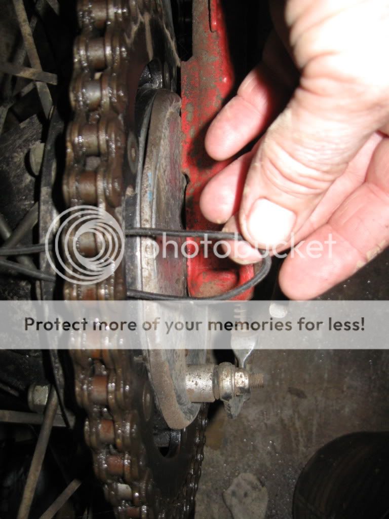

WOW, UNBELEIVABLE ???
Am I to believe that people actually use the marks on their swinging arm “for correct chain alignment”  ???
I AM CONTINUALLY GOB SMACKED THAT THERE ARE MARKETS THAT ARE BUILT AND THRIVE ON IGNORANCE ???

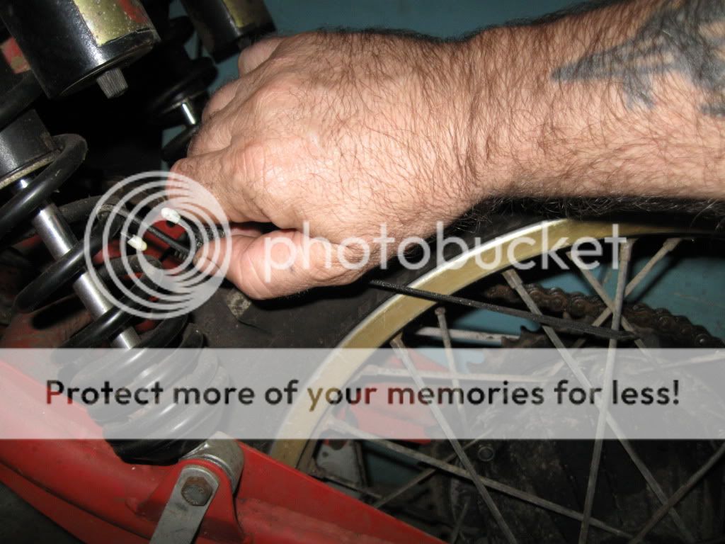

This is what I have been doing since the age of twelve(patent pending) ;D

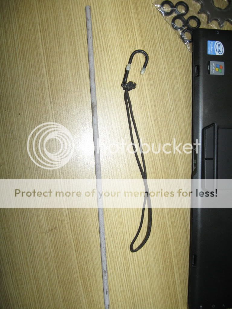

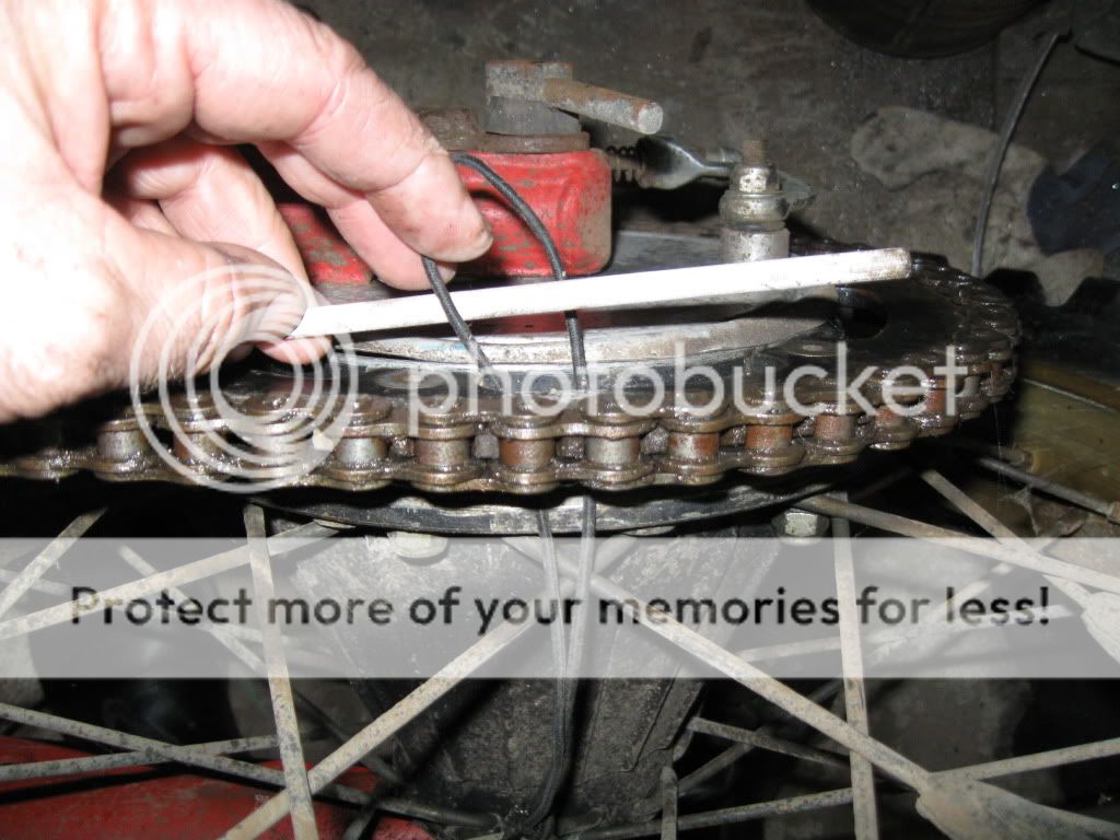

My kit, for chain alignment (patent pending) ;D
Take part one of the kit, rubber band. over the years I have added a hook(patent pending) ;D
Pass loop of rubber band through sprocket hole.
 Insert 4mm welding rod through loop.
Pull rubber band tight and attach hook(patent pending) onto the nearest suitable piont.

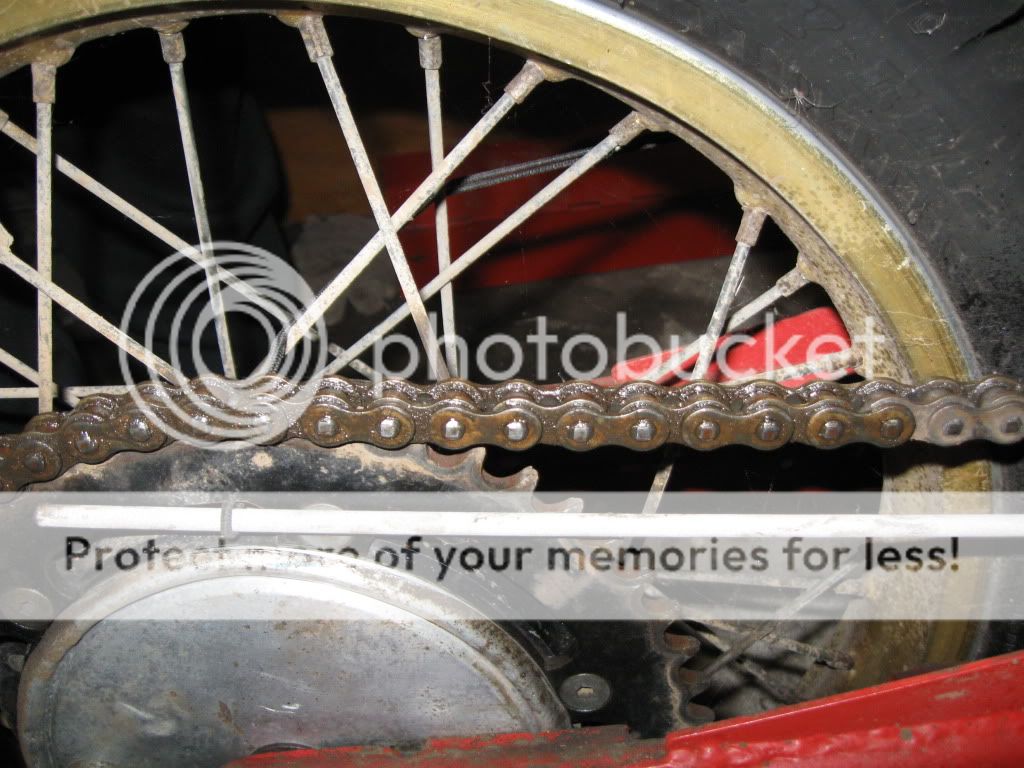

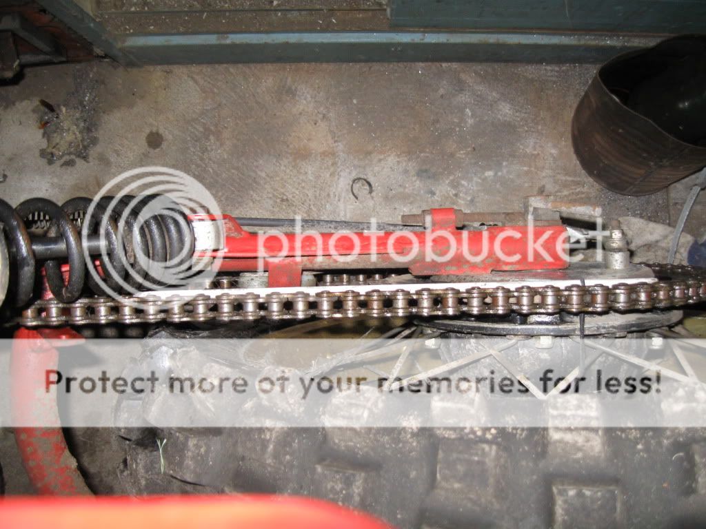

Obviously we then have this :o
Then look straight down of course, to observse optimun chain alignment.
Obviously the above RUSTY beast was spot on, when it was set two and a half years ago at Crawford River :D
  PLEASE, BEFORE ANYONE SENDS ANMORE MONEY OVERSEAS!!
I HAVE A FULL BOX OF 4mm WELDING RODS(all rolled on a surface plate to proove straightness), I CAN SELL YOU ONE, I WILL ALSO INCLUDE A RUBBER BAND(patent pending). I CAN GET MORE ON MONDAY ::)
DON’T GET SUCKERED FOR A FANCY GAGGET FOR US$25 PLUS POST. I CAN SELL YOU THE WHOLE “MICK KIT” FOR A MERE AU$10.
COME ON DOWN THE WATERS FINE.
 STAY TUNED FOR MY NEW TOPIC “DUMMER THAN DOGSHIT, DRESSED IN A BLUE AND WHITE APRON”. WITH TWO HUNDRED PICTURES(a picture tells a thousand words).

Thats why in the "MICK KIT" (patent pending) the indicator(4mm welding rod,patent pending) is attached directly to the SPPRRROOOCCCCCKKKKKEEEEEETTT  (patent pending). This is some times been referred to throughout the ages as "IDIOT PROOFING" ;D
