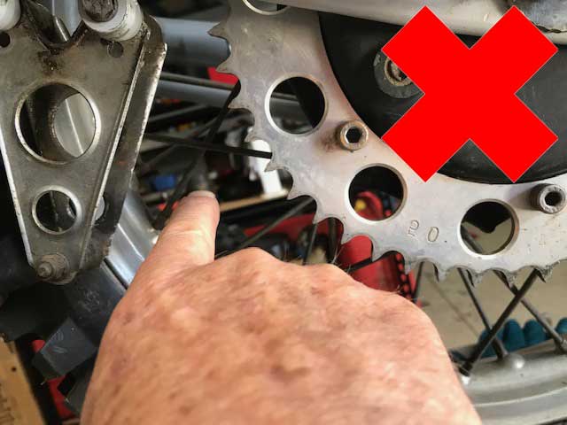

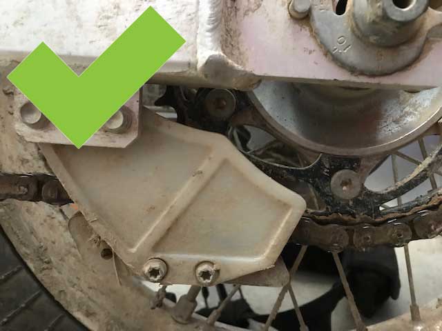

just noticed this in the regs.." no gap between the rear sprocket and the chain guide, " How does a std 84 husky chain guide go in this regard??
Same rule for classic MX. You must not be able to get your fingers between the chain & sprocket at the bottom (coz that's what happens while you're riding, wtf!). Your Husky is not compliant (most vintage bikes are not). Easy fix, about 1/2 hour's work & $10 for some alloy plate & a couple of bolts if you want to do it properly, or 3 minutes if you use an ice cream container lid & a couple of zip ties (got just about every bike through scrutineering at the 2017 Classic MX titles after MA put the rule back in the MoMS). Finding an ice cream container lid in the parc ferme may not be so easy though. I have plenty of photos of bikes which have been done but don't know how to load them on here.
bigk's explanation is right, and hopefully the illustrations below help too:
This is the correct arrangement. The guide covers the space where the chain meets the sprocket on the underside of the swingarm.
There's no chain on this bike, but you get the idea... This is a non-compliant arrangement. This gap needs to be covered.

hey Tex,you wanna flip that bottom picture around,doing my head in, ;D :P
