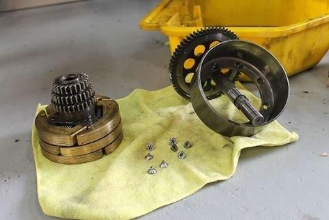

To carry on from the event report and a few photos i have an engine report on the mighty 1979 390 auto i rode at the Cookadinia vintage enduro. On the Thursday night before the event we fitted a N.O.S clutch pack and N.O.S first gear clutch... drum and shoes. On Saturday afternoon and until half a lap before our finish on Sunday afternoon man this thing hooked up like it was on steroids , however i made a rooky mistake when i replaced the clutch packs , i did not replace the securing screws in the main clutch drum.As result of this when had a main clutch failure resulting in just enough power transmission to get to the finish on what was our plnnned last lap, with a few cross country short cuts.Man this thing vibrated when this let loose. Cruised back to the pit  and we had a great laugh as it sat there and idled like vibrating madman .Easy fix and something to do next Saturday afternoon. Check out the photo's sheared the suckers right off.

One Teddy , it takes about 1.5 hrs to dismantle a manual transmission. (which you probably cant do because your only own a hammer , nail gun and assorted plastering tools)
Two Teddy , you usually need to remove the engine from the frame. (refer to above)
Three Teddy , the auto had a little problem and that took about ten minutes to dismantle and will probably take 1/2 of an hour to repair and assemble.
Four Mr Teddy you're a shit stirrer and i love it . (you would have loved how this thing was vibrating''''')  8)
