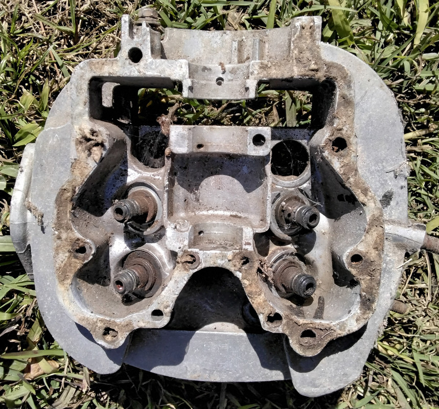

Offline Dungar Pilot
  • Posts: 126
Re: TL250 Honda
« Reply #17 on: August 06, 2022, 01:20:47 pm »
Hi Everyone,
OK, so I could hear the gears grinding, does this help?
Let me know if you want more detailed photos? This is a centre port and came to exactly as is, I thought TL 250 so I grabbed it but stand to be corrected.....
