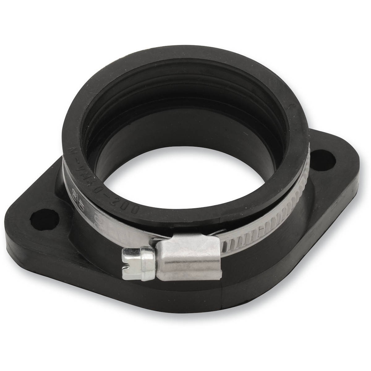

If you want to avoid welding, an alternative would be to use a flat plate with a 34mm hole in it (best done on a milling machine, but can be done by hand), four M6 holes to secure it to the cylinder reed housing and two more (tapped) holes to mount a rubber adaptor flange like this:
These adaptor flanges are available from many sources in many sizes (you can start by searching for "Mikuni rubber flange"...). As you suggested, you may be able to utilise part of your original (or remade) inlet manifold to obtain the reed block 'stuffer' portion - just see how it looks once you've removed the outer portion of rubber. It may be difficult to obtain a nice smooth passage into the reed block, so you could possibly make your own stuffer (from Araldite or Devcon or something similar) which will give a uniform intake passage and fill any 'dead space'.
