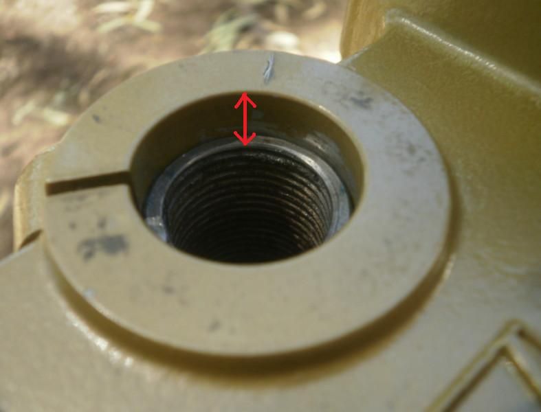

Will the stem in these clamps found in late 79's KTM and Canams just press out with a hydraulic press or is heat required as well?
Theres no pinch bolt so i think its will probably be tight.

Thats not what i want to hear. Has ANYONE removed one of these stems before? Lower looks forged so surely its just pressed in?
also how far from the top should the stem come here? I know it should not come all the way to the top though. I am guessing 3mm?

Should come up to within about 020", .5 mm or so. Probably not super critical but the pinch clamp doesn't want to be partly unsupported bad for it and the clamp security on the steering shaft.

Ok Thanks guys. I did not expect the stem to come up that high. I am 8 or 10mm from the top so need a new stem for sure. I would have thought at least 1-2mm for gap though to allow for adjustment when/if bearings wear a little.
