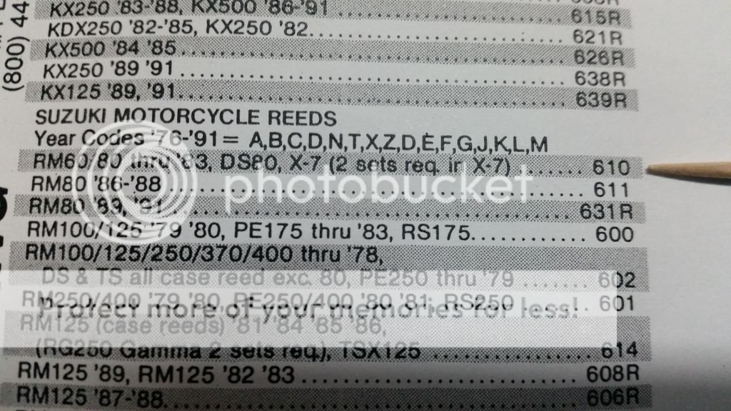

I still need someone with an RM80 to measure the reed dimensions as I don't fancy wasting money on buying a set just do check it.
Ban BLACK rims NOW
Re: I feel the need, the need for new reeds
« Reply #16 on: November 20, 2015, 11:07:19 pm »
Do not buy the RM80. They are incorrect.
I have emailed my oversea supplier. He will answer and he will know. Tis the weekend though.
« Reply #17 on: November 21, 2015, 10:57:11 am »
OK, got an answer :)
It appears that the earlier RM80 will fit :) just not the latter model ones that I measured for you.
Boyeson Dual Reeds #610
There are heaps on US ebay if your local dealer hasn't stock.

« Reply #18 on: November 21, 2015, 12:07:55 pm »
AWESOME!!!!! thank you
