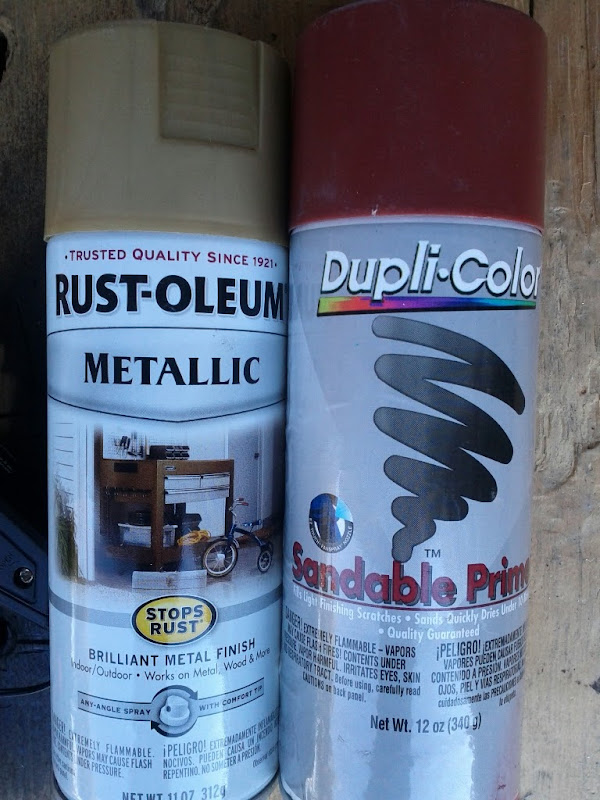

Also what is the colour  the bodies are painted , mine are deep read ,but its seems the original paint scheme is more of reddy / brown colour.  Any body know the bunnings equivalent or car colour code is   . Last thing where do it get a pair of stickers for the reservoirs ?

Color of the bodies was simply a red primer in a rattle can. Added clearcoat.

Beware, not all rebuild kits are the same... $100 will get you the bare minimum seals if I remember well.
Here are the cans I used for the colors (bought from Orchard Supply Hardware www.osh.com ) . They turned pout very good.
