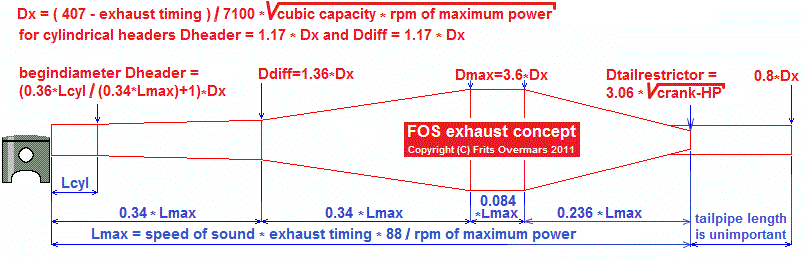

 Seems the only thing your missing is a decent pipe  to start surprising more exotic bikes.
Blair and Frits Overmars both have good theory to base a pipe on that will out perform any of the old after market or stock chambers and a good place to start.
 You can download a demo software that works for calculations free or you can buy it. ( Direct link so save as and run as admin)
http://ypvsbox.free.fr/software/PipeDesignerDemoEngSetup.exe
 And you can use either Blair or Overmars calculations.
