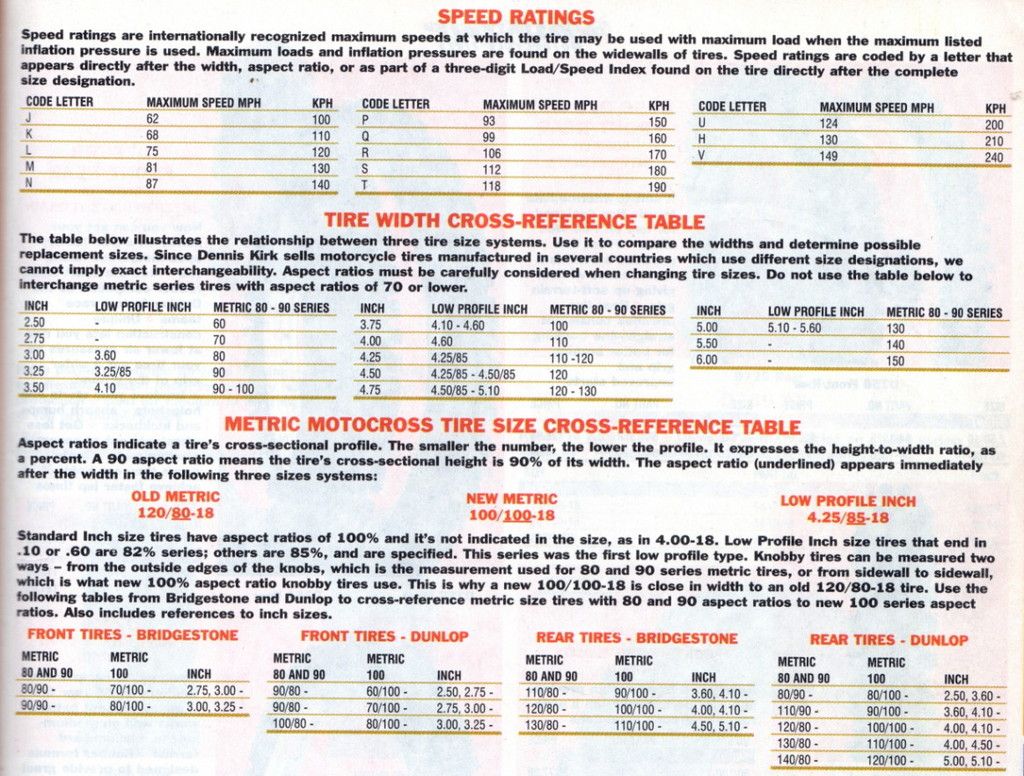

From memory in metric 100 aspect rati0 width is from the carcase and 90 aspect ratio is from the knobs. I have a good chart/doc that explains all this but its not on computer and i will have to scan it unless i can find it online.
I think this may be it, i have it in an old printed catalogue
https://www.denniskirk.com/learn/tire-sizes-explained
Re: Tyre sizes for IT175
« Reply #7 on: May 29, 2016, 07:31:03 pm »
Everyone except Michelin uses the case size, AFAIK.
Michelin is moving toward normal sizing. All their newer models seem to use conventional sizing, and I've seen older models with stickers for the normal size.

Unreal, thanks. That explains why the rear is ridiculous, it is a 120 Mitchy, on a 175 ::) (rubbing everywhere) and thanks for that chart thing too Leith. Saved 8) . i think I will print/ laminate and stick on the wall.

Looks like i did remember correctly.
