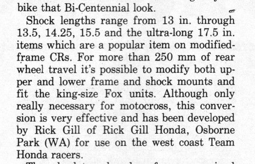

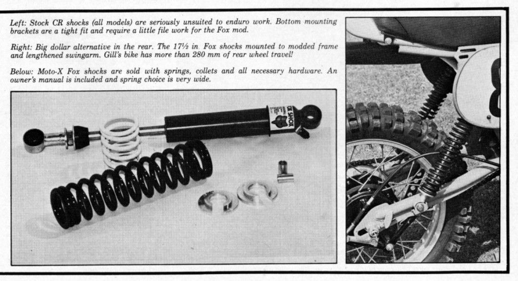

Rick Gill @ Rick Gill Honda in WA was doing these sort of mods to Hondas back in the 70’s This one is a modded 1975 CR250
As soon as BigK said that above I immediately thought of this. They were doing it to use up surplus/over supply of the 75 models and make them competitive against new/more advanced bikes so maybe even could have been doing it to 73/74’s at a later date too. Maybe a customer wanted his older model updated?
This scan is from a 1978 published magazine article on converting the 75 CR250 to MR enduro specs. They mentioned that Rick Gill Honda was doing these frame mods to get 250mm+ travel from the 75 and maybe earlier? for the WA team Honda bikes in motocross. He was putting Marzocchi leading axle forks on them too so this was around 76-78 for sure.
